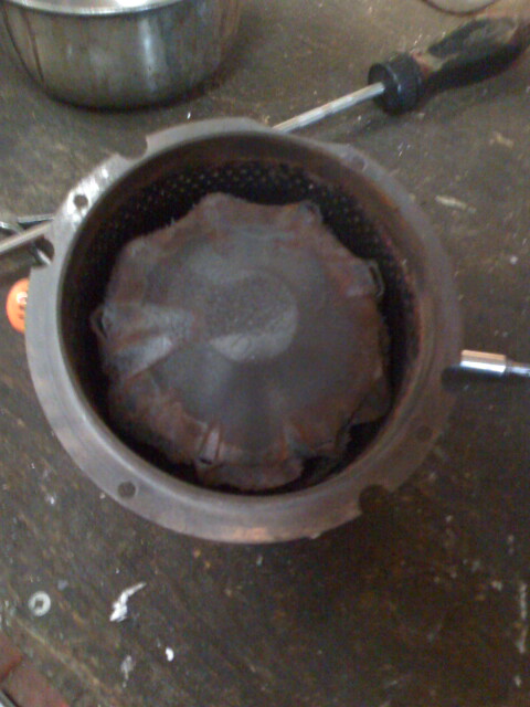

        This is what is wrong with most M422s. The burner ring has mushroomed out around the top part. The top part of the ring is over the bottom part and is exposed to the flame. Since it is only tack welded at 5 points, most of the surface is free to warp with the heating and cooling of the flame. This happens to almost every M422 burner ring. It can take anywhere from a year to 5 years. Once your stove starts quitting and has a bad flame it’s time to look at the ring and burner mat. If it’s been 3 to 5 years since you have had a service, it’s almost a give’me what the problem is. You may have other problems as well, but the ring and mat should be the starting point. This repair cost the owner $200.00, parts and labor. The Monitor parts cost about $175.00. For you DIY’s try the Carswell Distributing site on the web. They have a parts break down page that will be helpful.
          • 755
          M422 repair
          Sorry, my math is a little slow. This job cost the customer $300. $175 for Monitor parts and $125 for labor and test.
