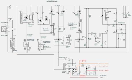

        The 2A fuse also powers both blowers, the solenoid damper, and the pump. Try pulling their leads off the PWB and then powering up with a new fuse. If one of them got 220V when your neutral came off, it could be shorted.
