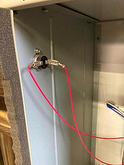

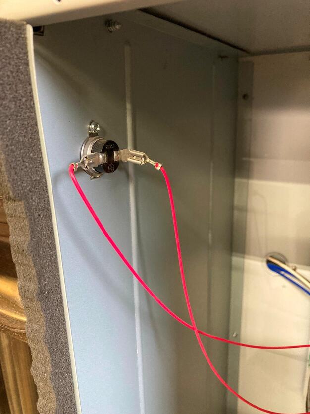

    Be very careful around the overheat sensor on all new Toyostoves, as it is a hot circuit and the connectors have no insulation on them. If you touch it and ground yourself, you will get shocked. If by chance you touch it with a screw driver or wrench and ground it, it will blow the fuse. Hopefully you only blow the fuse and don't burn the main board.
