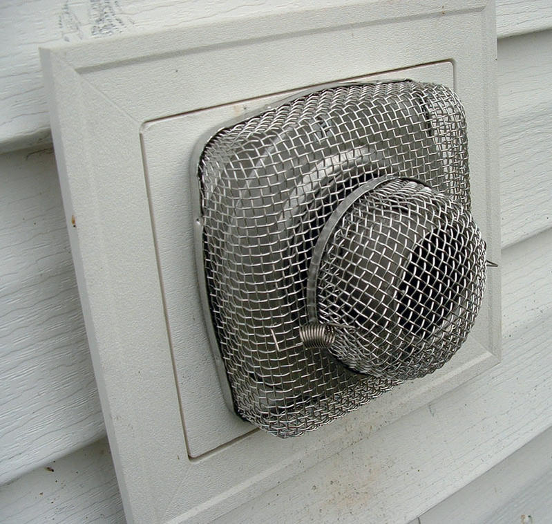

    From Amazon, I ordered 1- Camco 42150 Flying Insect Screen - WH200 and 1-Camco 42141 Flying Insect Screen - FUR200.
    I measured the diameter of the exhaust snout and used a Dremel with a cutoff wheel to cut a hole in the center of the WH200 screen and slid it over the exhaust snout. I spread the square base to snap over the round intake/exhaust base as shown to protect the intake.

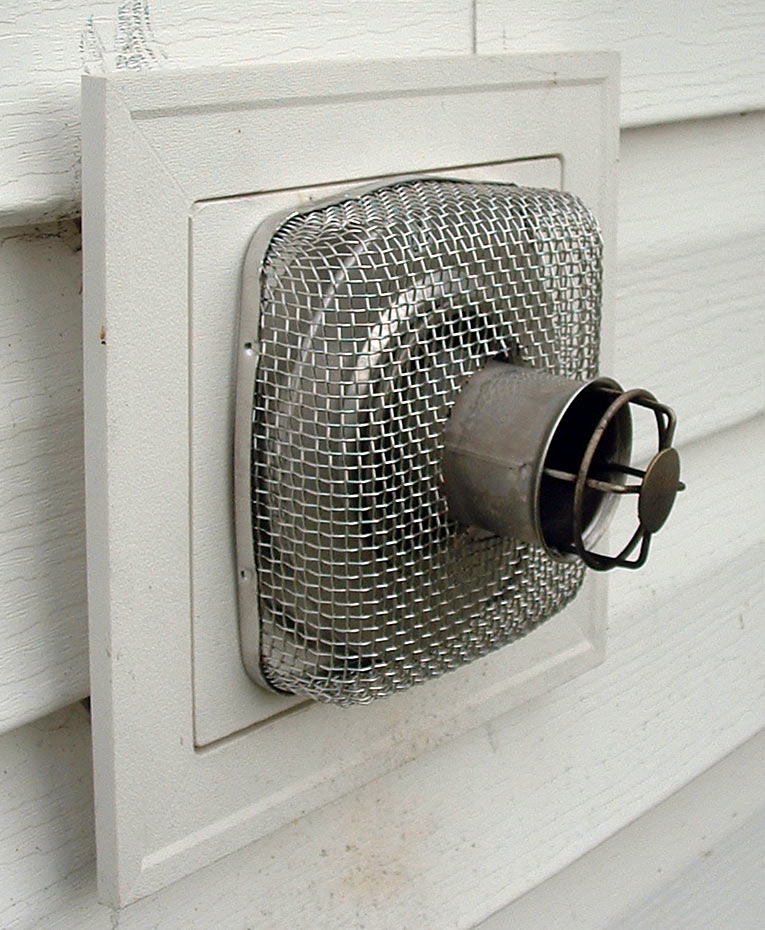

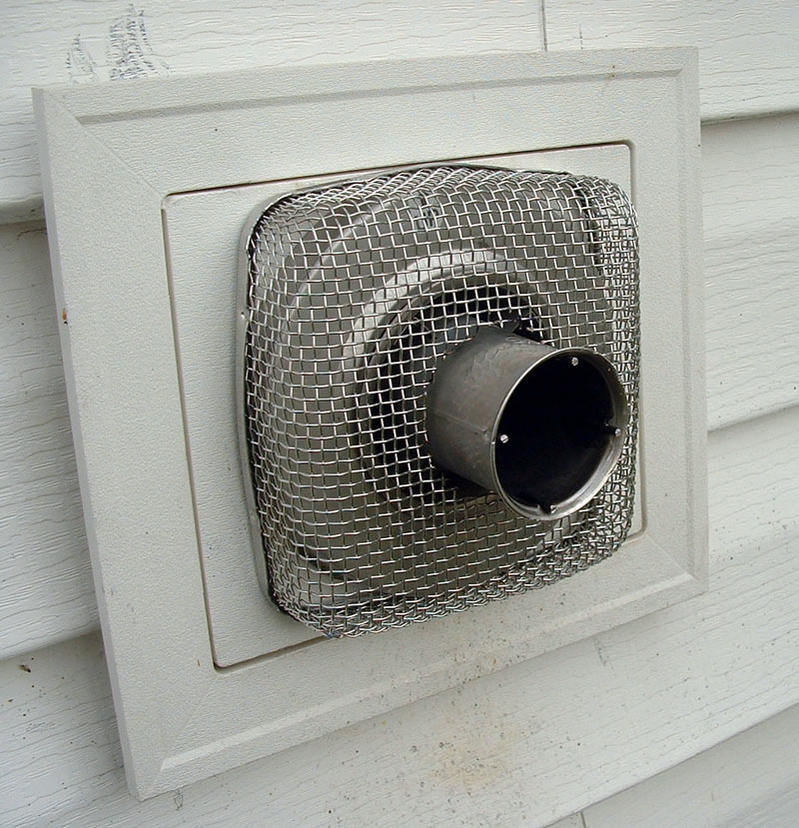

    Next I cut the bird guard off the exhaust snout as shown.

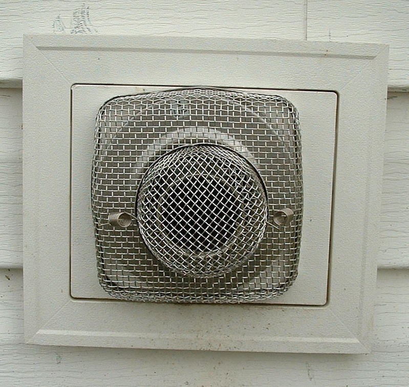

    Then I used the two springs from the WH200 to attach FUR200 screen to the WH200 screen as shown.
ID:	87938 Click image for larger version
    Now I am (hopefully) completely sealed against wasps and ladybugs.
