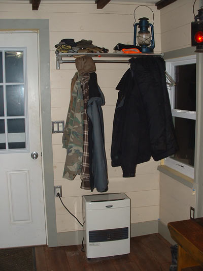

    The other night I had my L30 throw an EE12. The Fan screen was partially plugged. We had started hanging winter clothes above the heater and apparently all the little fuzz that was on the clothes dropped down and became lodged on the screen, closing off about 1/3 of the screen. Not enough air over the heat exchanger and the unit shut down. Cleaned the screen and everything is fine again. Will have to check that more frequently in the future. Just an FYI.

    I added a picture.
      • 758
      Where is your drip tray?
      • TechEditor
        • Dec 2014
        • 58
        It was a used unit and didn't come with one.
