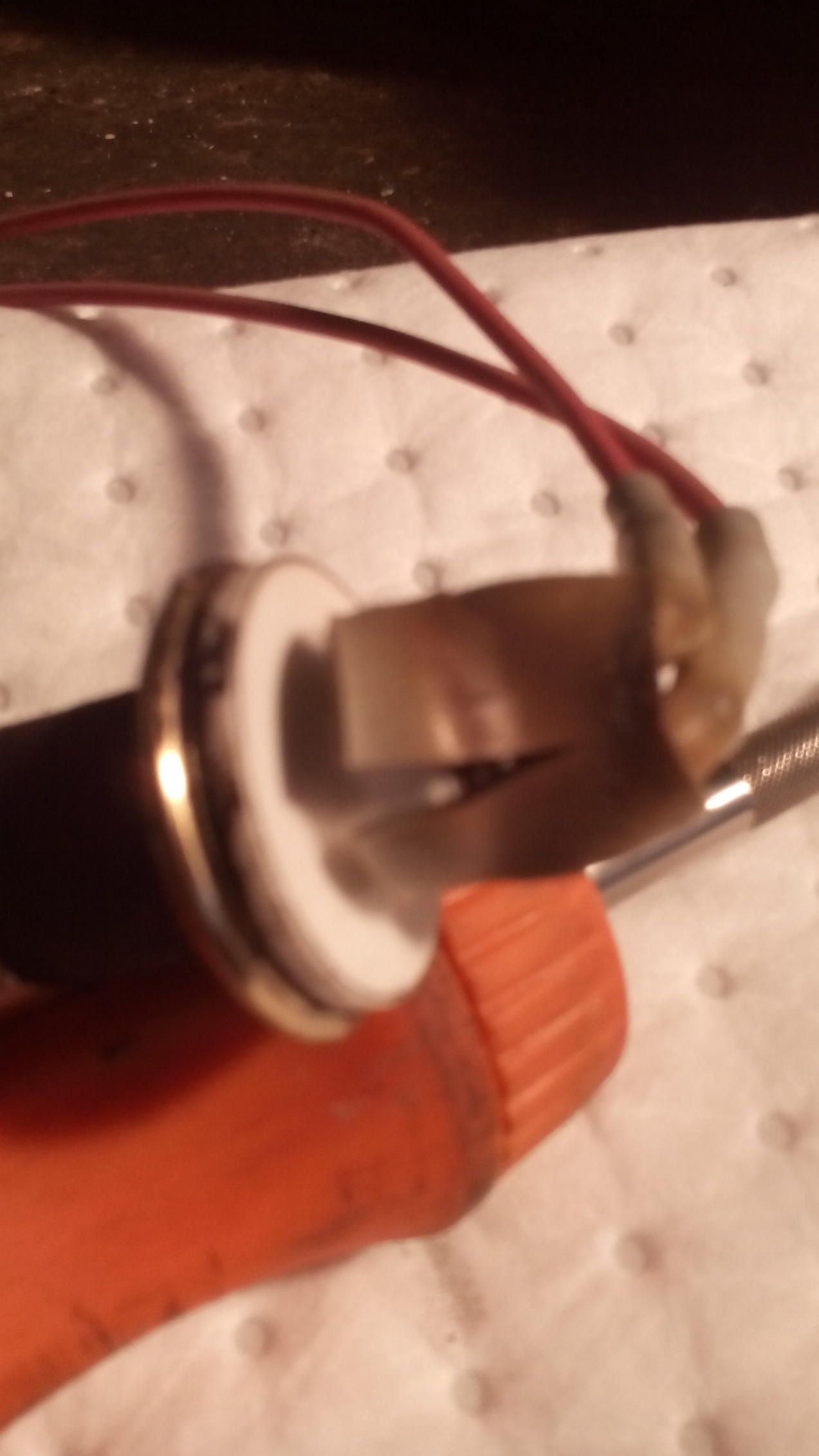

If your igniter looks like this it's time to change it. If it gets hot due to a dirty circulating fan or bad burner mat, the wires can become de-soldered and fall off.
