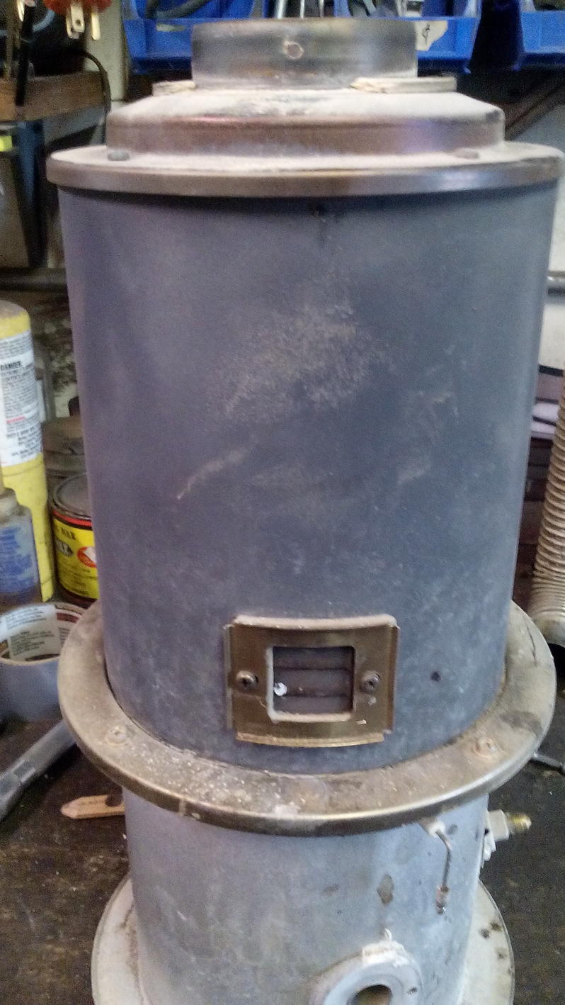

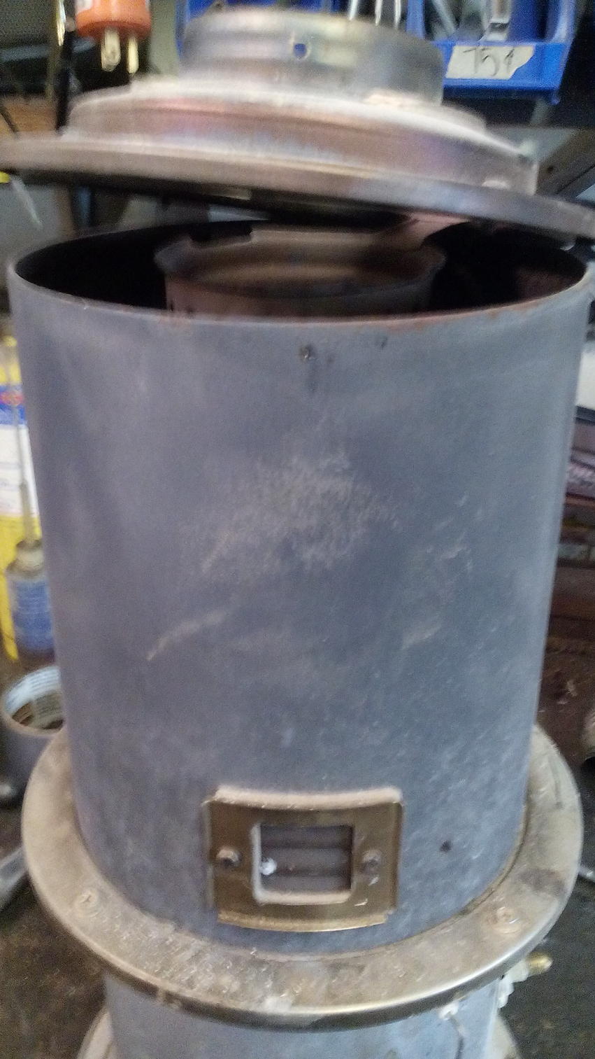

    If you have an older Laser 56 heater that is giving off an odor or has a stained front panel, you need to inspect the heat chamber. If it is cracked around the top it needs to be replaced with the new style chamber. The new chamber is a welded unit and costs around $150. While you are at it this is good time to service the whole unit.
