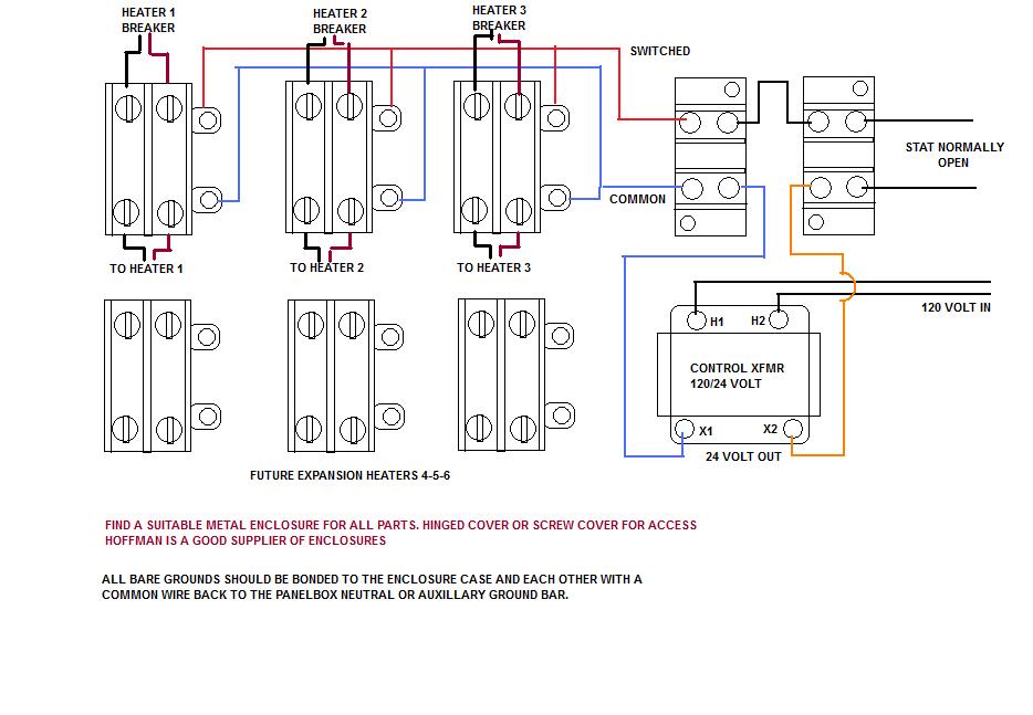

                    I've attached a diagram of how to hitch up a circuit for your heaters
                    The diagram shows 3 active contactors and 3 spares.
                    If you wish to connect up additional heaters to their own contactor
                    operating off the common digital "stat" just duplicate the wiring.
                    You'll need to find a metal enclosure for all the parts.
                    The control transformer is a 120 volt primary with a 24 volt secondary
                    Size should be around a 50VA size.
                    Get two terminal strips of three or two screws each for inter connections
                    Suitable hardware for fastening the parts inside the enclosure.
                    A lug for the grounds

                      Yes that is correct. Each BB Heater has it's own Breaker. How you explained/spelled this new install out is how I visualized as well. As you pointed out it's the Homework on the Hardware of devices that I will need. As well finding a new Stat that will use only 2 wires with an Internet access feature. Most likely that 3rd ground is not important for it's operation although, I will run it anyhow and maybe just pick up a Ground of the Ufer of my Home. You have been very helpful & I sincerely appreciate youhelp. May I ask which state you live in? Tazzman
