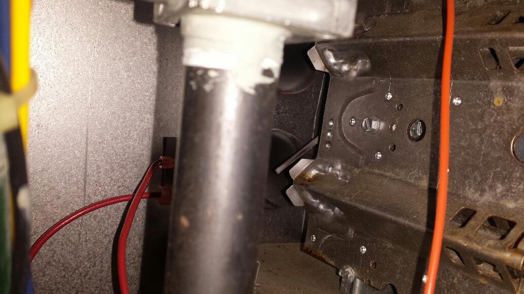

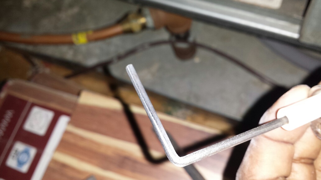

          The rod was dirty so I took it off and cleaned it with a soft sandpaper sponge. I attached it back and it still does not work.Click image for larger version

          The first one is before and the second is after I cleaned it. I had the unit serviced last year for the same issue and the company replaced the pressure switch. Could I still have a switch problem?
            flamerod
            make sure when you replace the flamerod that the probe doesn't touch anything made of metal.
            it has to be in free air to function.
            when it grounds out it stops working and its circuitry will lock out your burner.
            the way it works, is, it detects the ionized air in the presence of a flame. normally there is a.c. on it. In a flame it changes to d.c.
            with no flame it stays as an a.c. current
            a pressure switch would be normally open until pressure is applied, then its contacts close.
            use a jumper wire to verify this. just jump out the common to open contacts and see what happens, but don't leave it in the circuit.
