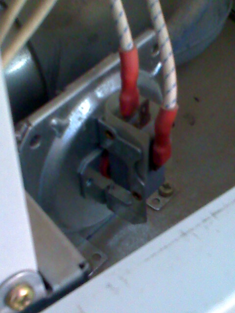

            Ok, so it's been a few days since I've been able to work on the heater. I put the new air pressure switch in and put the unit back together. I tried to start it and no luck. It is still the same problem as before. The heater will go through the normal startup cycle. The fan will turn on, the display goes to four bars, the ignitor will heat up, and then it will shut down with all 8 bars flashing.
            I disconnected the switch again and jumpered the connectors to see what would happen. It started up right away again. Is it a normally open switch that closes when activated? I have one lead on the NO and the other on the COMMON. I believe that is correct. There are two ports for the air tube. Does it matter which one I connect the tube to?
            During the startup phase, I can feel that the blower at the back of the unit is sucking in air. If I move my hand across it, I hear the air pressure switch click open and close.
            I'm not sure what to check next. Any suggestions?
              put your meter on the RX1 range and connect it between the C and NO, now blow into either port. the port that closes the switch is the one to use, the other is open to atmosphere. the air switch is a neoprene disk with a pin in the center connected to a microswitch. constant air flow deflects the diaphragm and pin, closing the switch. as long as there is air flow, the switch stays closed. the air is necessary for combustion. if there were no air the kero fumes would back feed into the blower and your could have an explosion inside the tubing and pot. so the switch is necessary as a part of the safety string. remove the far end of the cappillary and stick it into a jar. start the heater and see if any fuel comes squirting out. if it does then the pump solenoid is ok. if not, then either the controller or the pump is toast.

                  • 758
                  air safety switch
                  The air safety switch is a NO switch. The two outside prongs are used. The hose goes on the top hole.
                  Sorry for the confusion on my part. The switch does close during operation. The marking on the switch are NO, NC and C in that order. The wires go to the two outside prongs, NO and C.
                  Again sorry if I confused you.

                    hawkins, so with air on the diaphragm the switch is open? that don't make sense!

                        So it DID close! Hawkins was saying that the switch is wired common to normally closed, which tells me it OPENS when energized. That's wrong. It's supposed to close completing that part of the initiate string.

                          Ok, so I had the chance to look at it again last night. I did check the switch first. It works just as Hawkins said - normally open and top port for the hose. The switch is fine.
