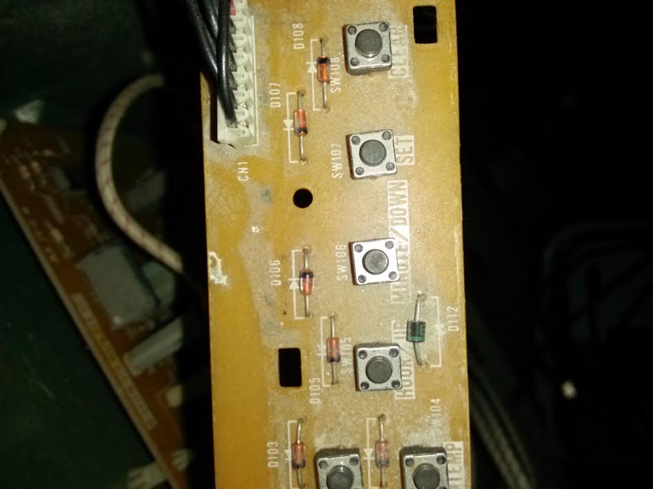

                pic
                Originally posted by OnTheEdge
                Rob if you are looking for the buttons I think you are I may have some. I have a few boards from a parts machines that I have pilfered a few bottons from to replace broken ones on a machines I have in service, They are not difficult to change if you have any soldering skills.... Little square buttons for the settings etc?
                If you can you put up a pic of the buttons you are looking for I can remove 1 or 2 that you can have.
                here is a picture:
                • OnTheEdge
                  • Sep 2015
                  • 22
                  Yup, I have a board that has a few left on it. How many do you need? PM me your Address and I will get a few out to you..
