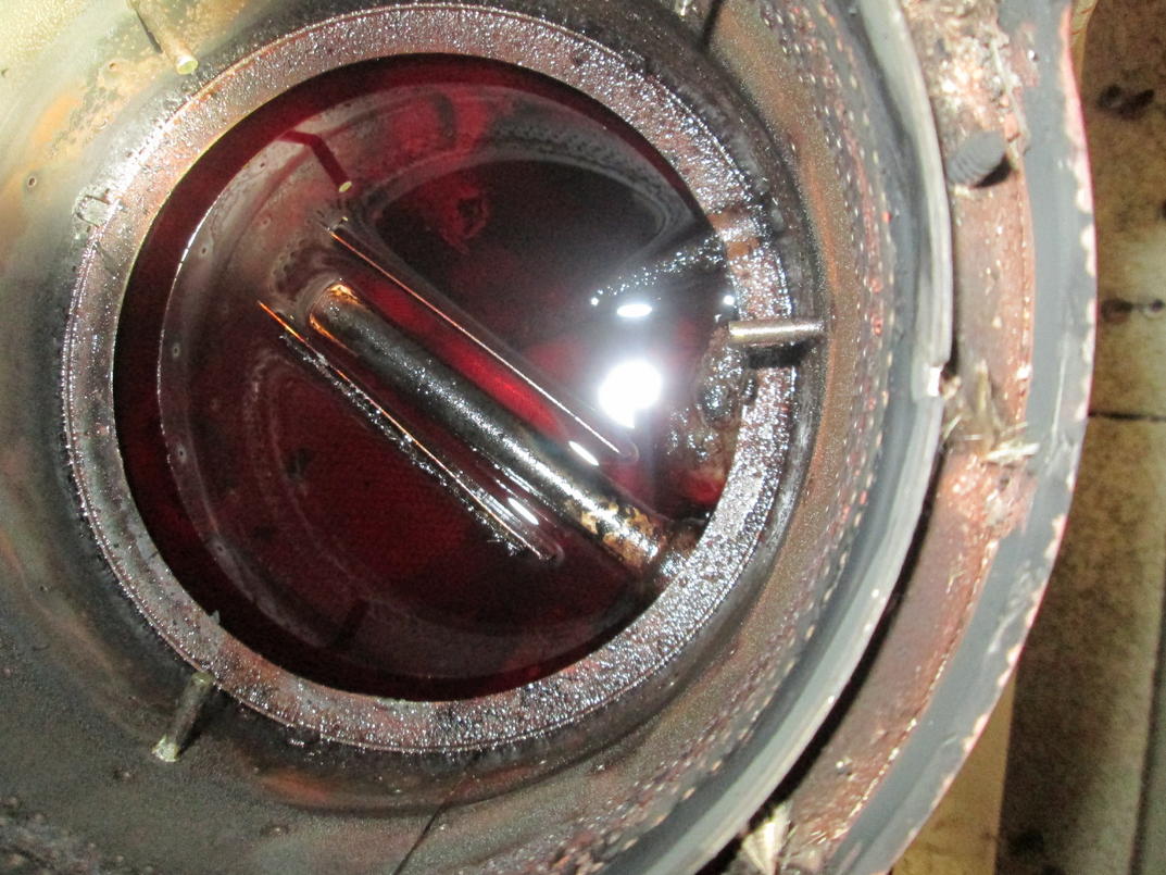

                          Flooded Burner Chamber
                          After the Blizzard yesterday I had a snow drift cover up my monitor vent and woke this morning to the flashing lights. I shoveled out the vent and after a couple relights had a look inside the chamber. I thought everyone on here would like to see a flooded burner chamber. I've got most all the kerosene out but I still am having trouble getting it lit. After it is flooded does anyone have any tips on how to restart the monitor. I had the chamber only "damp" with kerosene but it still wouldn't relight. Click image for larger version

                            After the Blizzard yesterday I had a snow drift cover up my monitor vent and woke this morning to the flashing lights. I shoveled out the vent and after a couple relights had a look inside the chamber. I thought everyone on here would like to see a flooded burner chamber. I've got most all the kerosene out but I still am having trouble getting it lit. After it is flooded does anyone have any tips on how to restart the monitor. I had the chamber only "damp" with kerosene but it still wouldn't relight. [ATTACH=CONFIG]2152[/ATTACH]
                            I'm not even close to being an expert...but I would think getting some rags in there to soak up the fuel would be the first step. Just this morning I wet my "new wick" and used rags to collect any liquid fuel. Just wanted the wick damp.
                            When I put it together this morning...had to wait a good amount of time before it took off again by itself. Again, just had my first unit apart this week..but I suspect there is a cycle the unit goes through a couple of time before firing up after being flooded?
                            Ed

                              Flooded Burner
                              I've dried the burner out until it was just damp but I didn't have any luck with the relight. Does the ignitor itself need to start dry? FYI this was a rebuild / new burner mat from 2009.

                                Originally posted by Chris K
                                I've dried the burner out until it was just damp but I didn't have any luck with the relight. Does the ignitor itself need to sta.rt dry? FYI this was a rebuild / new burner mat from 2009.
                                I really can't answer that...but can tell you that my Monitor "took a good amount of time" after being plugged in, temp set and "set" button pushed in. The intake fan just ran continuously until it finally fired up....may want to just wait it out...the fan must vent out the fuel vapor and possibly dry out the ignitor?
