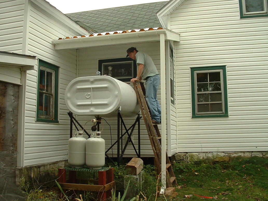

          My tank is at 18" head. I set it up that way with a rotating laser. See images for tank and valve and filter.
ID:	87373Click image for larger version
          Had to get the tank quite high to get that 18". The stand is cross braced and welded.

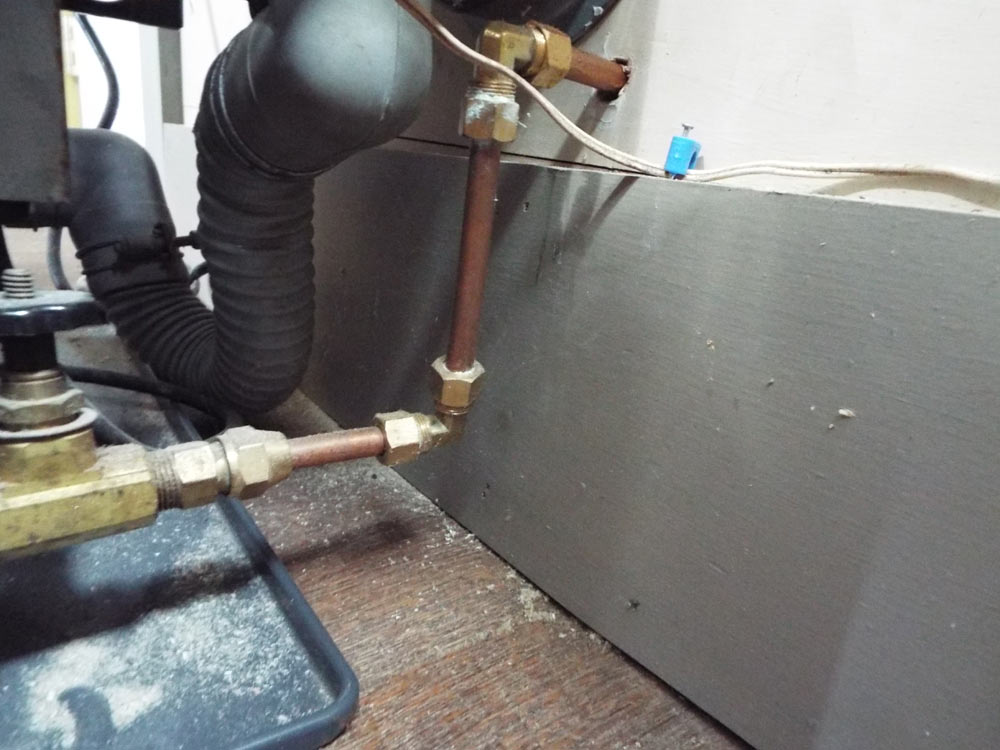

              Here is an update on the flair vs compression discussion. I always had problems with my flairs, very hard to make, some cracked and most leaked. It was just easier to use compression. I was discussing the matter at work and I was asked to bring in my flair tool so it could be examined. When I did, I was told what I was using was junk!
              The tool allowed the flair head to go off center and it was a swaging style. I was told to purchase an eccentric style. And they found me the correct tool on Ebay! So my flair tool went into the metal skip at work for recycling!
              When the new tool arrived we did some test flairs and it was 1000% easier! No longer did I have to practically stand on the tool to get enough pressure to make a half-ass flair. This tool slowly rounds the pipe into shape on each turn of the T-handle and it clicks the T-handle out of driving when you have reached the proper flair.
              So I reformed the new copper line to the L-73 that needed a new length when the living room walls and floor were redone.
              Before with swage flair tool:Click image for larger version
              After with eccentric flair tool:Click image for larger version
              Obviously it was my original flair tool that caused me to dislike flair fittings!
              Now will I re-do all my compression fittings? Not likely. They are installed and working w/o any leaks.
              My Laser 30 fuel line: Click image for larger version
              Now at least I know it was the tool and not me and I can now do future kerosene lines with confidence.
